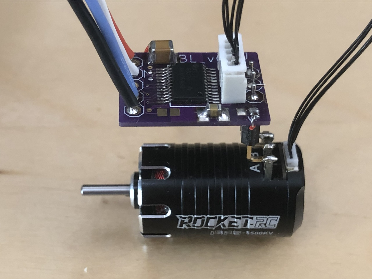

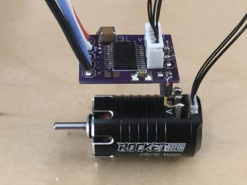

RE: Experimenting with Sensored Brushless Motors - Dr_C2 - 10th-Aug-25
[attachment=42058]
Here is the driver module sitting on top of the motor.
The driver module will sit closer to the motor for vehicle installs perhaps 1-2mm separation.
The thin black wires connect to the three Hall sensor ICs inside the motor. At the moment I am using plug connections for simplicity - however for vehicle installs the large (relatively speaking) white JST plug can be replaced with direct wire-to-pcb soldering to save space. And far shorter black wiring too.
c

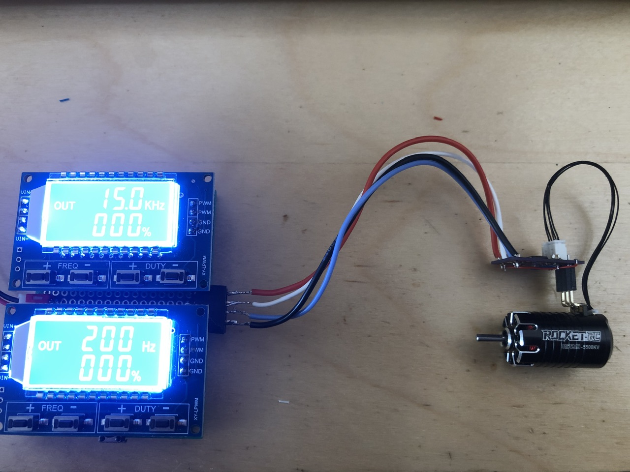

RE: Experimenting with Sensored Brushless Motors - Dr_C2 - 14th-Aug-25
[attachment=42102]
Here is the SENSORED brushless motor and piggy-back drive module connected to two PWM signal generators.
The motor drive PWM is set to 15kHz as per the Texas Instruments datasheet.
The brake circuit PWM is set to 200Hz - a much lower frequency since the datasheet doesn’t specify the permitted bandwidth of this input.
The dual PWM assembly includes a brake activation button.
Previously I reported the brushless motor and experimental drive module function correctly in terms of motor drive.
I am pleased to report, now, that the brake circuits are functioning correctly too.
This completes bench level testing. Next up, will be the installation into NSR AMG and NSR F1 chassis.
Surprisingly - all continues to go perfectly to plan. Long may this continue :)
c
