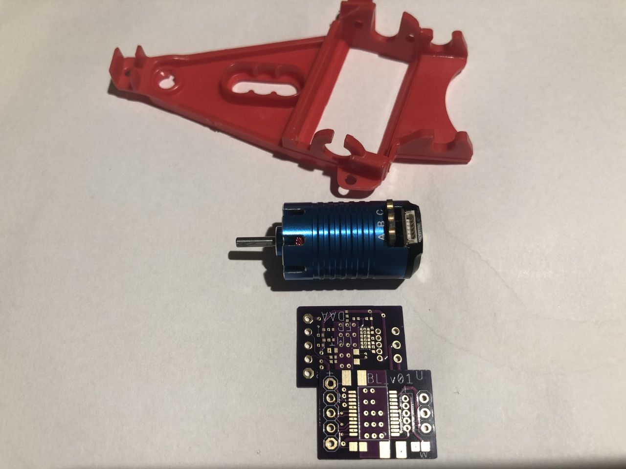

RE: Experimenting with Sensored Brushless Motors - Dr_C2 - 3rd-Aug-25
The first batch of SENSORED brushless driver PCBs as shown earlier are intended as miniaturised evaluation/development boards - and importantly they can fit inside a digital slot-car. As development boards that’s why they include a couple of diagnistics 8 way FFC sockets too.
But meanwhile I designed a variant which is smaller and is closer to the final design. And guess what? they have arrived from the manufacturer super fast.
These new boards similarly attach directly to the motor; piggy-back style.
The photo below shows an NSR angle winder mount, a 3500Kv sensored brushless motor and two of the latest brushless motor driver circuit boards. They will all fit together in due course.
The SENSORED brushless motor has a diameter of 15mm, a length of 25mm and a 2mm shaft diameter. The fixing points match those of standard slot car motors which avoids any requirement for mounting adapters.
The new circuit boards as shown measure 15mm x 20mm.
[attachment=41985]
Note: on the underside of the circuit board there is a 6x3 matrix of small square pads - these are for the ‘configuration’ jumpers for the Hall sensor ICs. Small but not too small ;)

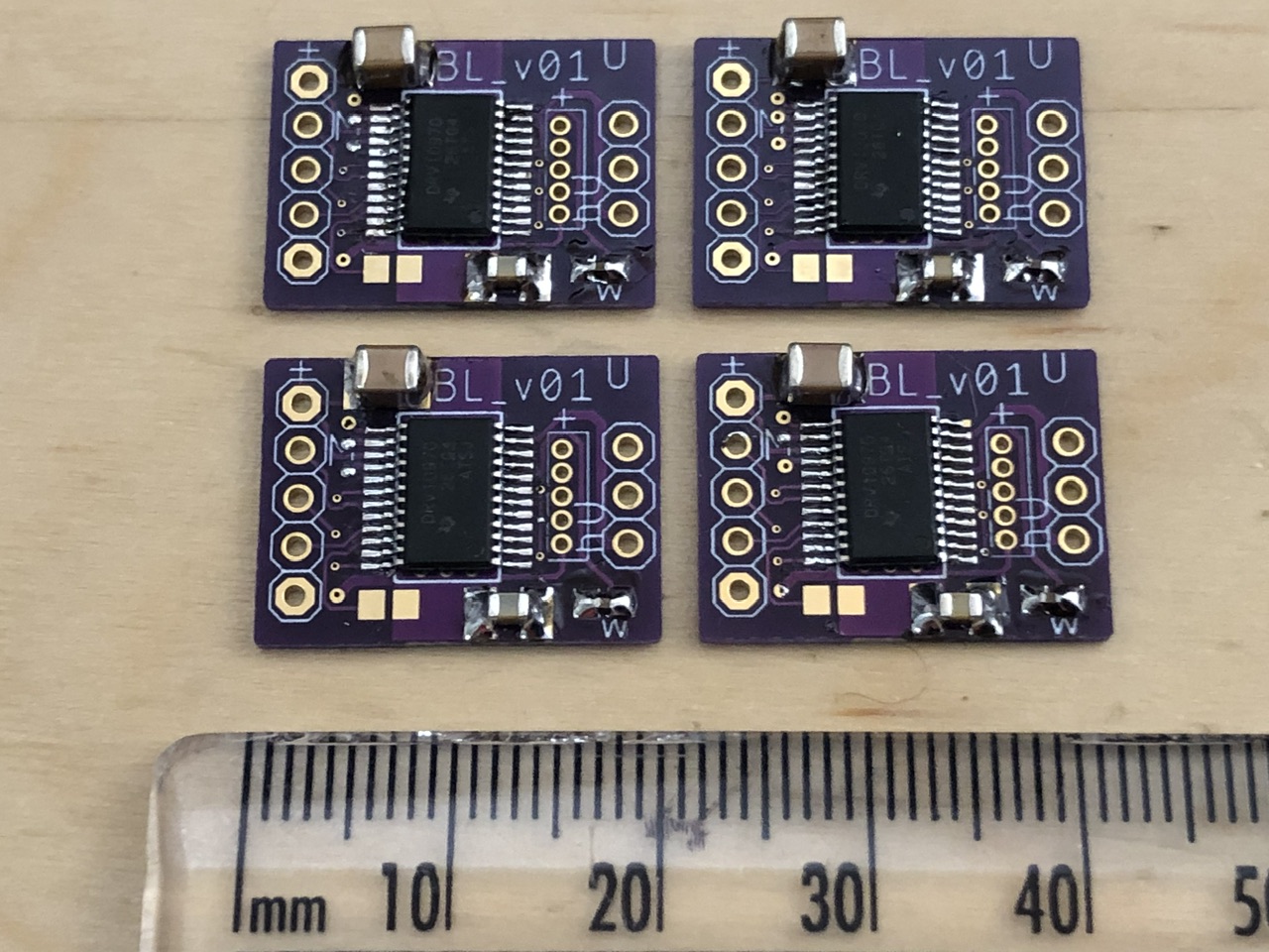

[attachment=41986]
Four assembled driver modules for SENSORED brushless motors. To complete they each need a 5 pin 1.25mm pitch micro JST socket to be added for interfacing with the motors’ internal Hall sensor ICs. Soon they will be complete.
Once the sockets arrive, motors will be powered up.
No complications detected so far … all is looking good ;)

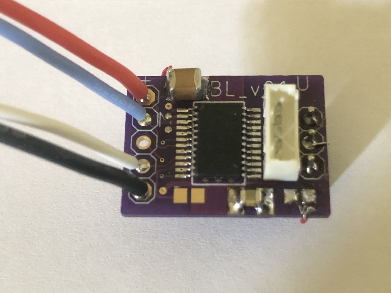

RE: Experimenting with Sensored Brushless Motors - Dr_C2 - 10th-Aug-25
[attachment=42057]
Here is the 15mm x 20mm SENSORED BL motor driver module. The photo was taken after the module had been put under test with a BL motor and spooled up to max rpm.
At the moment the driver module connects to the motor windings with a 3 pin header socket. It connects to the Hall sensor ICs via the micro-JST 1.25mm pitch 5 way socket.
We are fast approaching final design. So far there have been a few learning points:
1/ Changing motor direction is not as simple as brushed motors where reversing two wires is all that is required.
2/ The tiny jumper adjustments using 0402 0 Ohm parts does work successfully but it is tediously time consuming to implement by hand. And, since only two distinct configuration patterns are needed, the simple answer is two pcbs pre-configured with each of the patterns.
3/ Learning that the internally generated 5V is auto switched off whenever the motor stops has been important and cautions against its use beyond powering the Hall sensor ICs.
All good learning and the fact these small boards successfully spool-up my SENSORED BL motors, and with fine control, represents significant progress.
