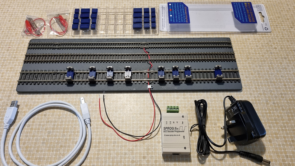

A PC DCC programming/Rolling Road test board has been set up:
[attachment=31540]

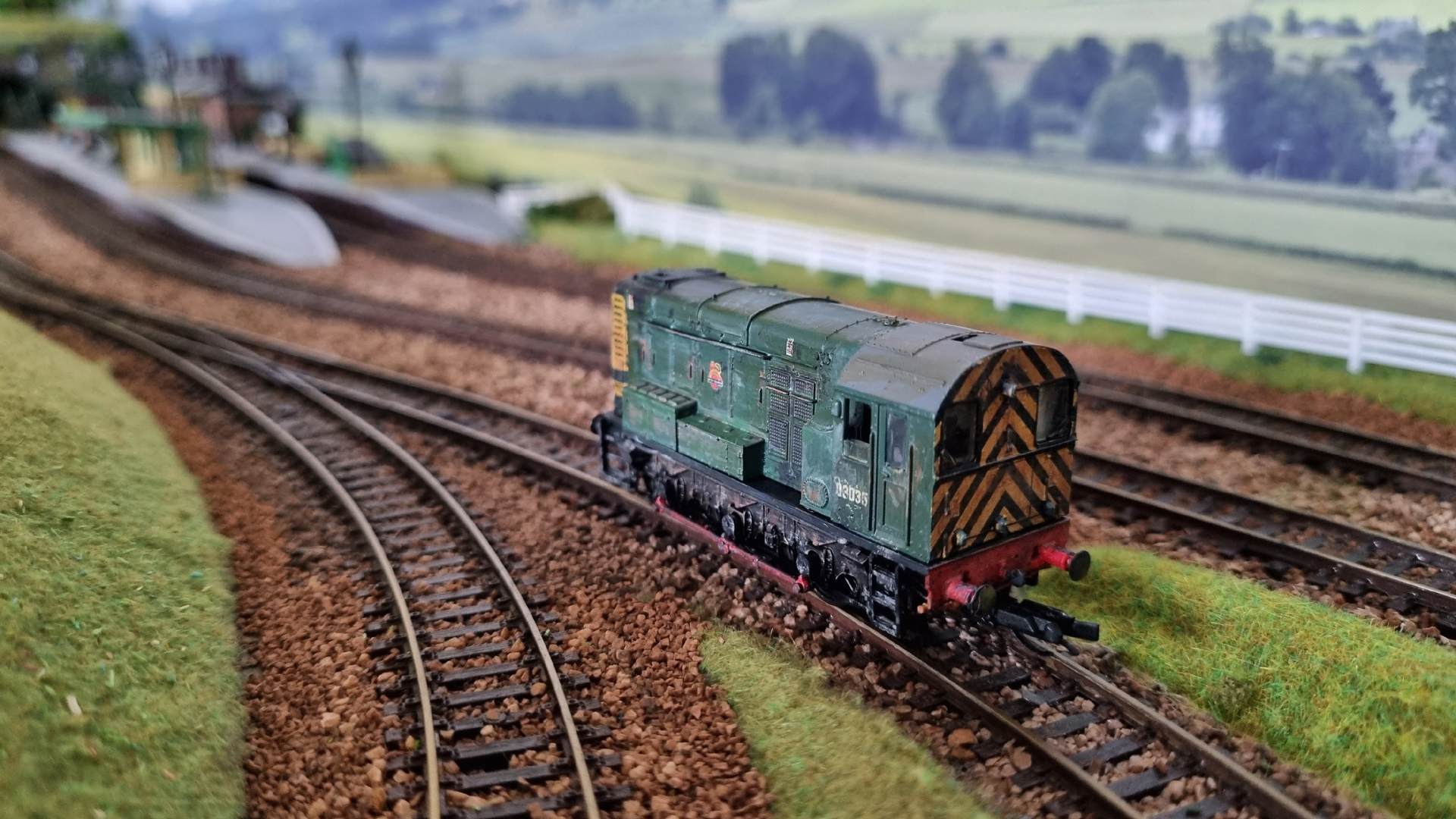

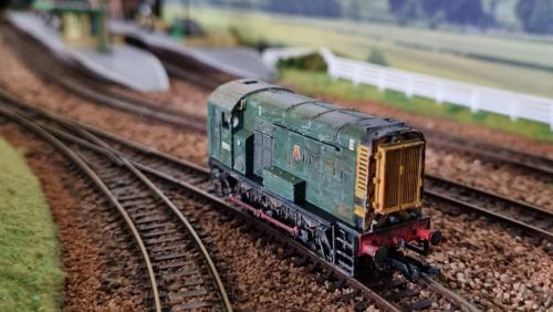

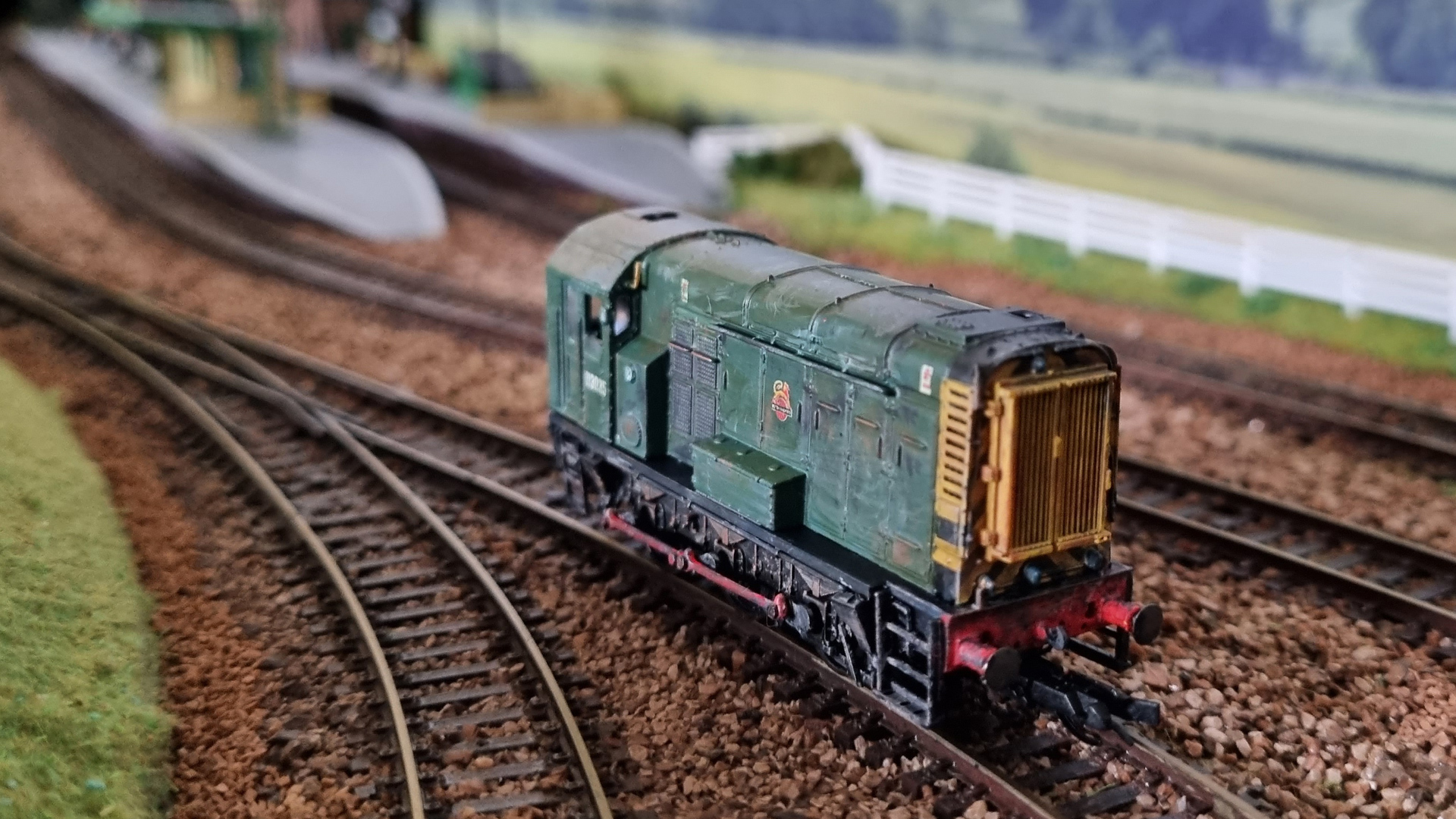

One of my Class 08 has now been re-liveried to an early BR version and weathered.
The other had an oops moment and is currently awaiting parts, but will be painted to represent a J45/DES1 (A forerunner to the class 08, which were about in later LNER days).

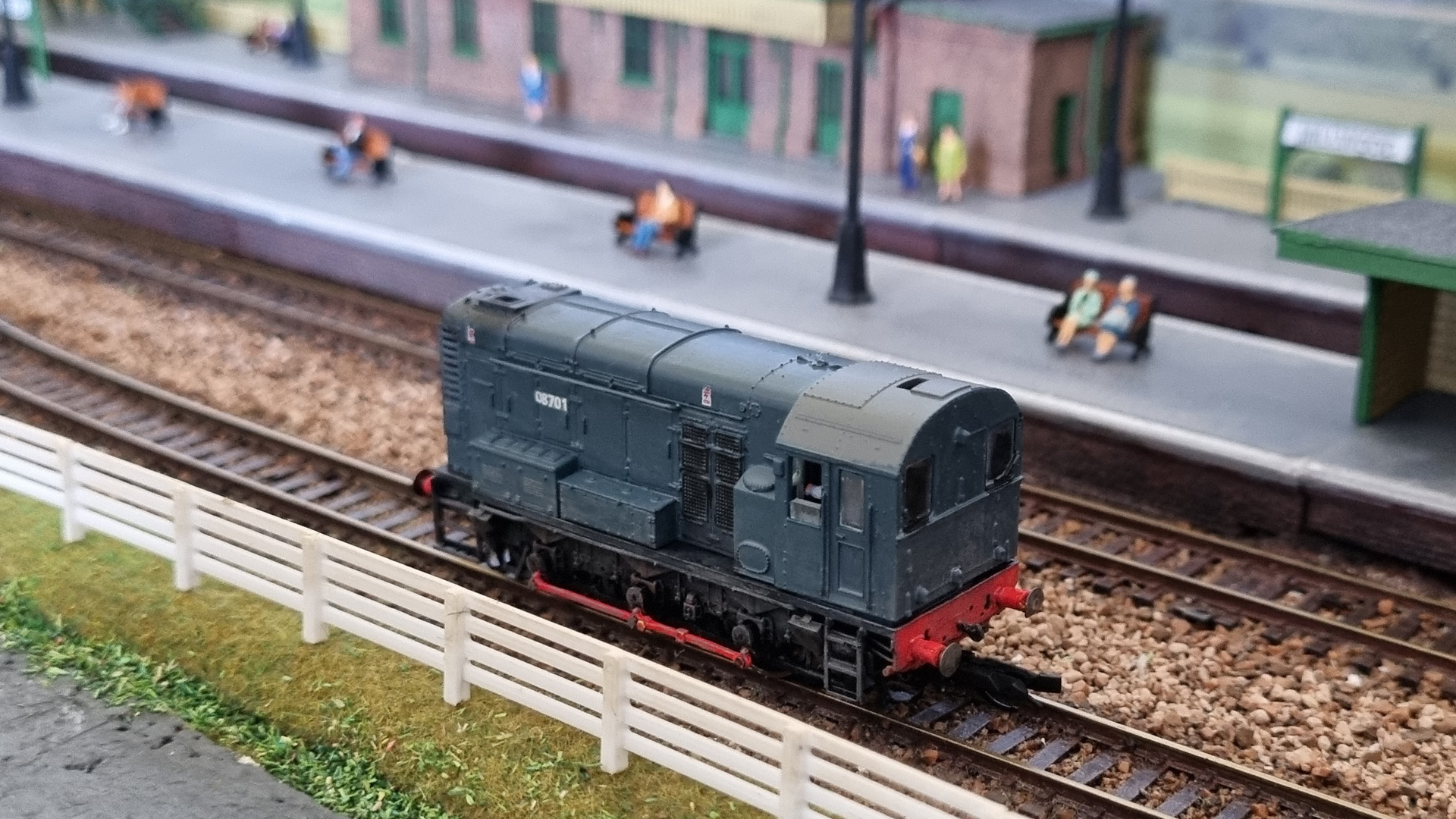

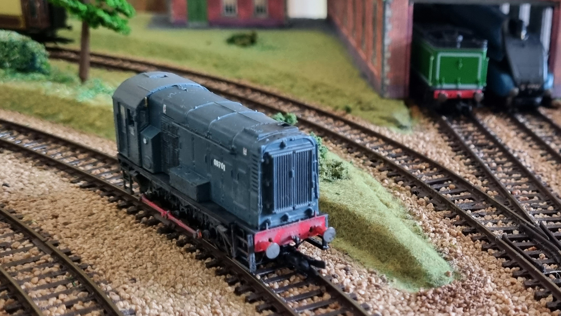

And the 08 re-liveried to resemble the earlier J45/DES1 in LNER guise.
There are some differences in the shape detail, but overall look is similar enough for me to be happy to invoke rule 1
Actual solid information on the colours for these is thin on the ground but I decided to go with a grey blue as I had seen someone else's 00 model conversion and liked that !
It would have been 2-3 years old so I wanted it to look used but not as heavily as the BR one. I may have overdone it, but it is what it is
