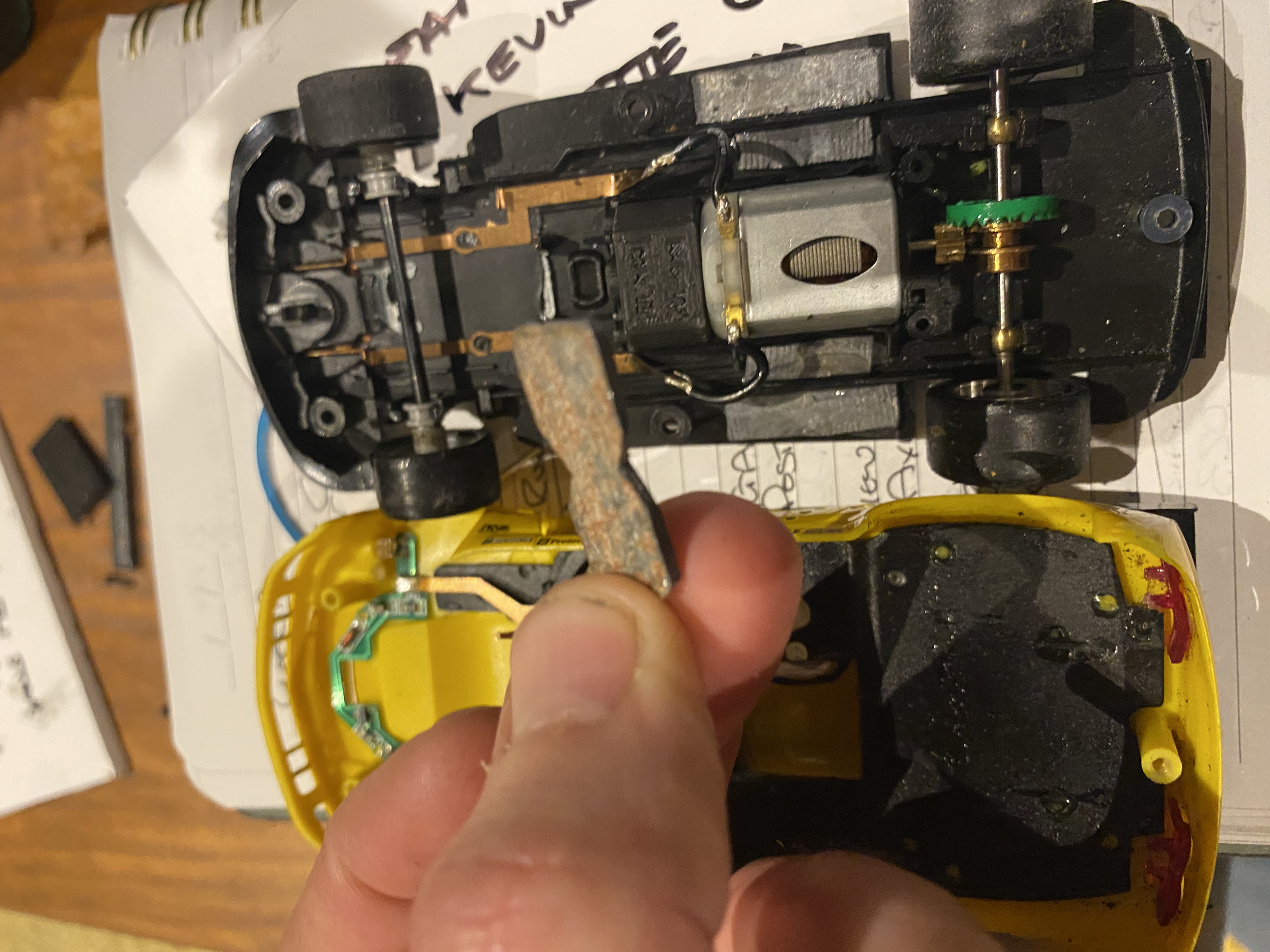

OXO Cube's Class A Corvette:
[attachment=27367]
[attachment=27368]
Was an easy fix, very obvious where the weight had come loose from.  It's been clipped into place with a small dot of glue each end. Will hopefully stay put now

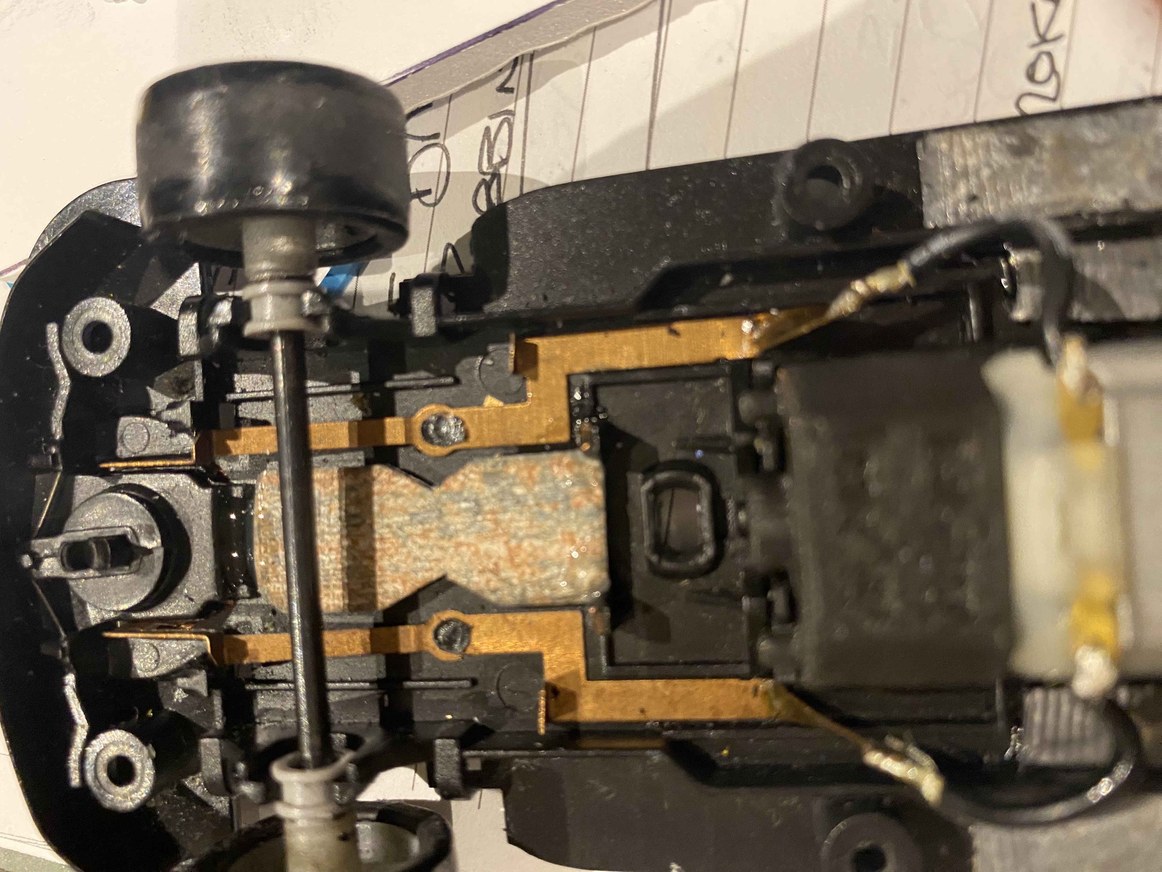

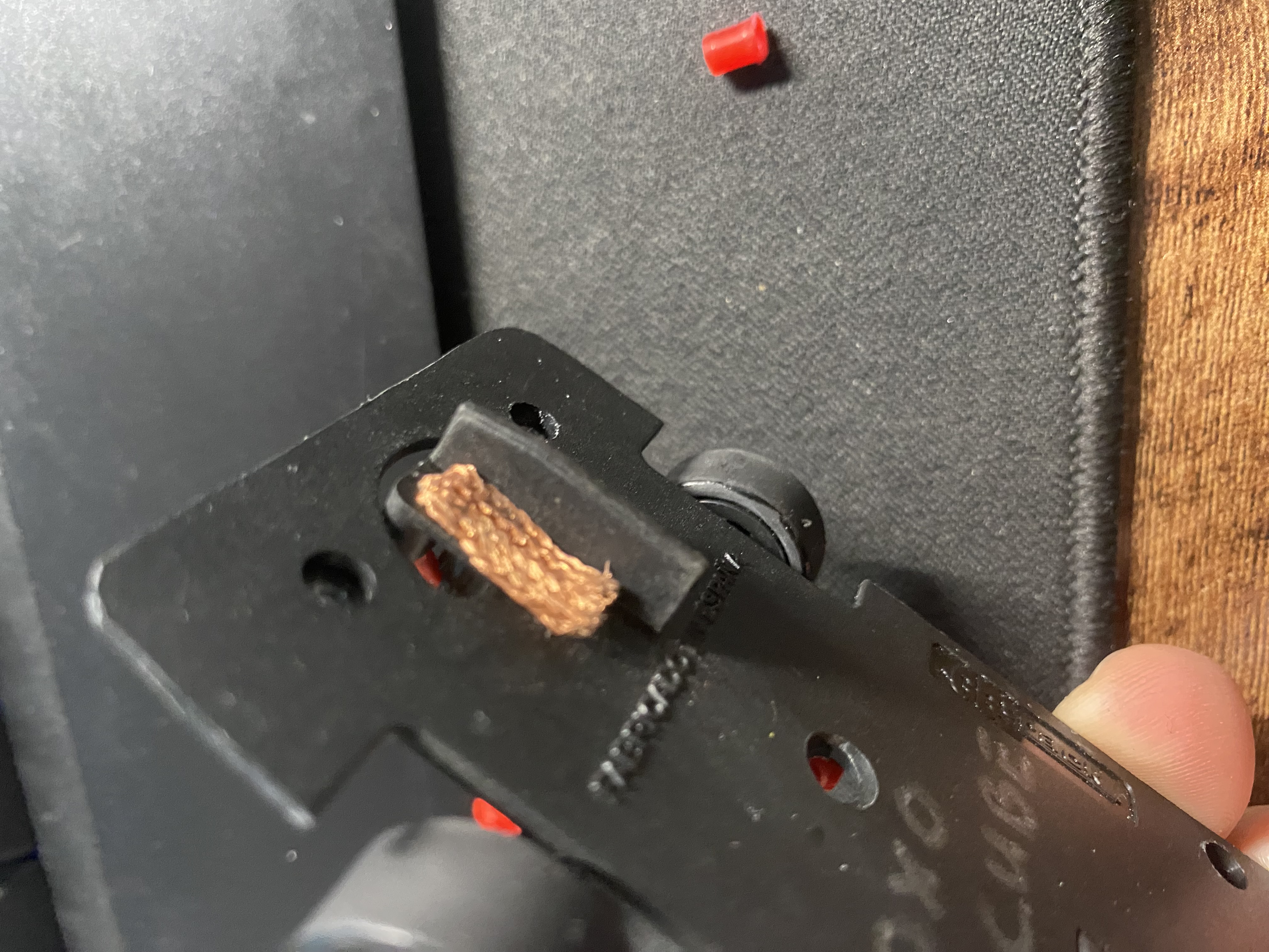

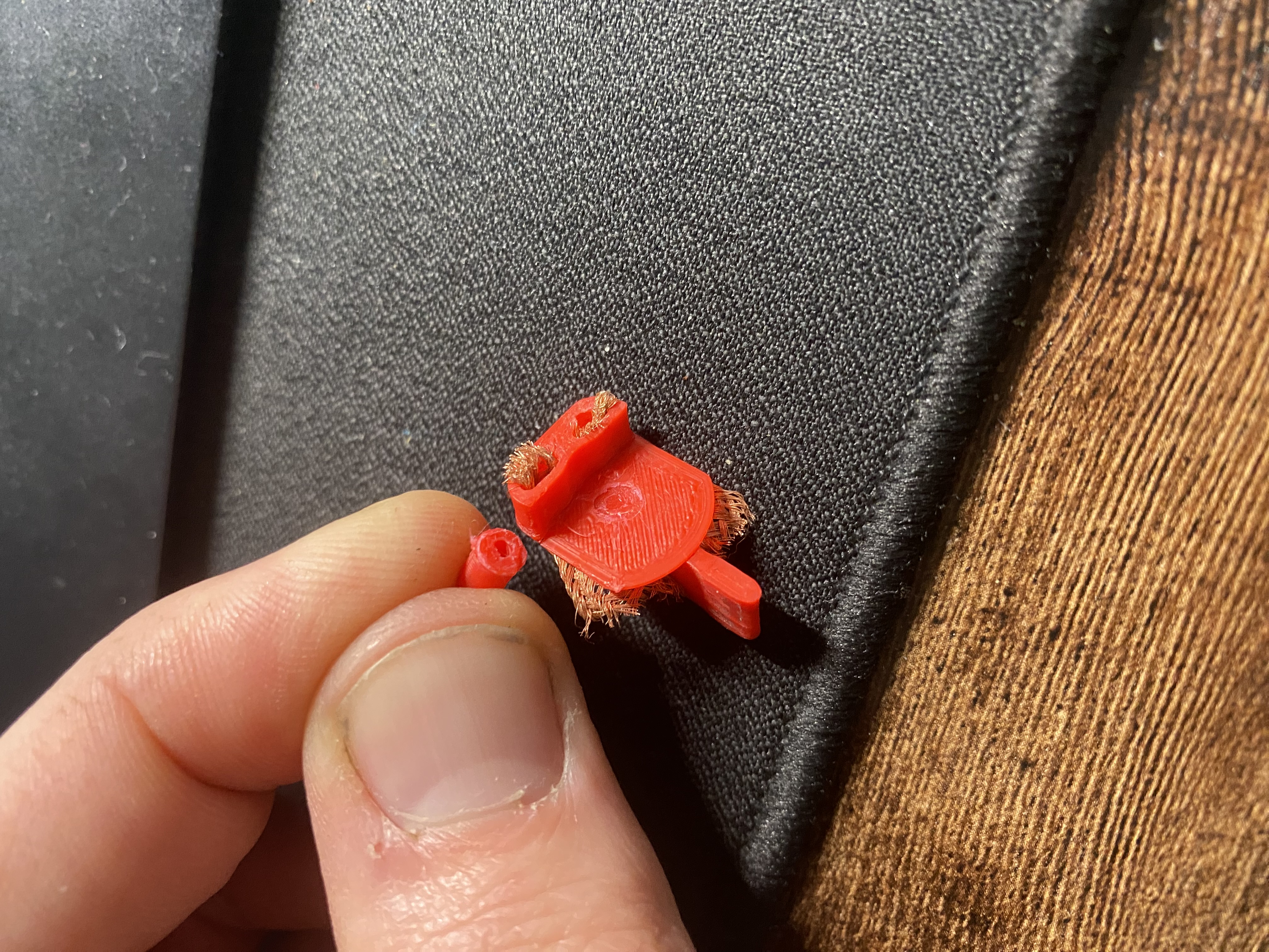

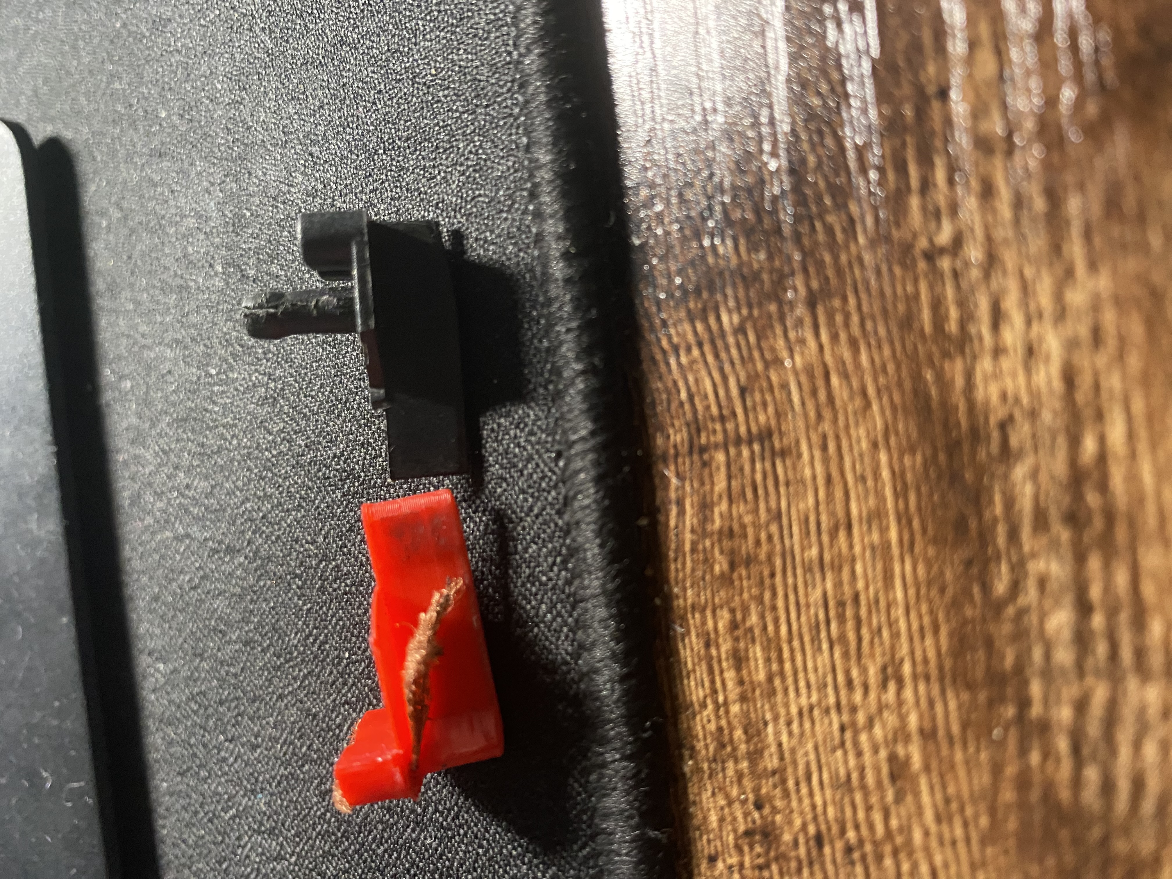

Oxo Cubes Porsche 917K guide:
[attachment=27378]
Guide post sheared off.  I had a rummage in my spares bin and found a slightly molested but otherwise functional Slot It clip in guide. It was about the same length and a gnats arsehole off the depth of the broken removed guide.
[attachment=27379]
All fitted and functional (The original braid was reused as it slid out the old and in the new easily enough).

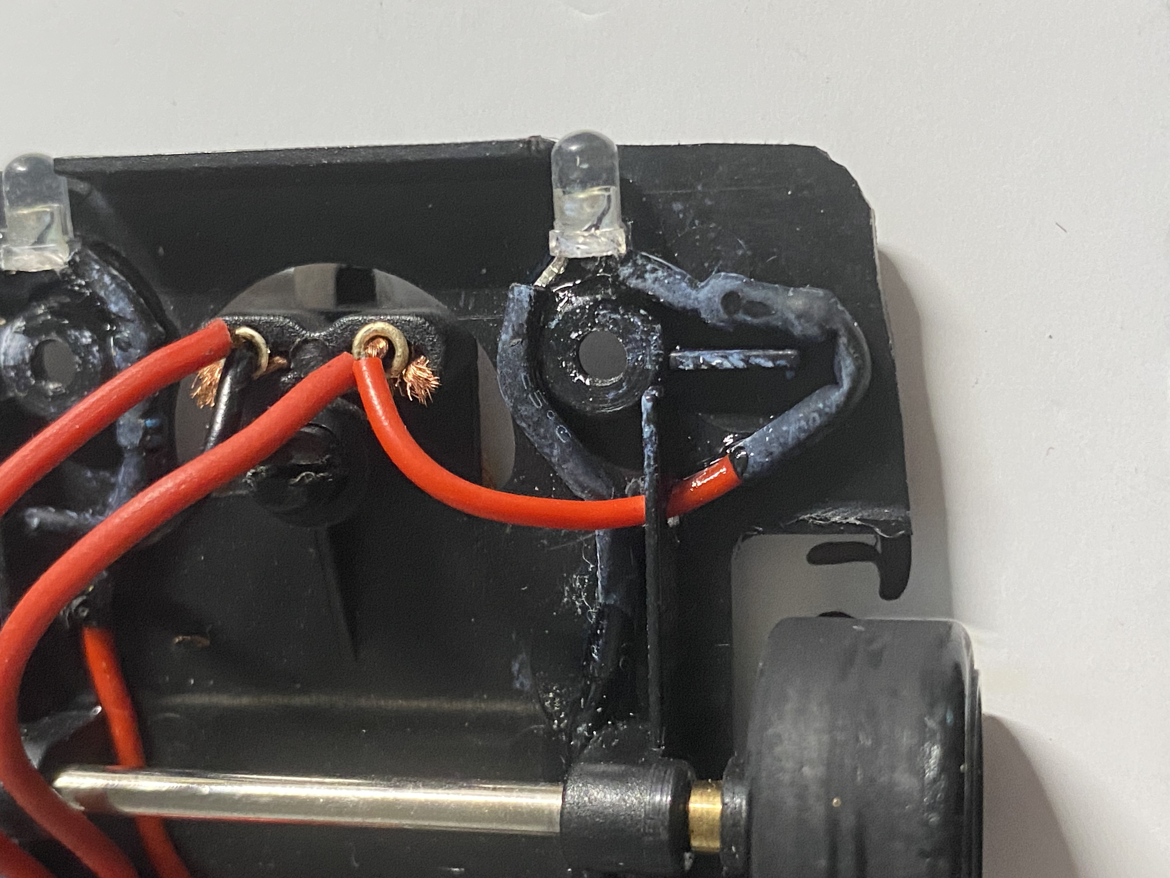

[attachment=27380]
The short wire for the front lights does come under a lot of strain under full lock, but it is what it is and will hopefully last the final rounds

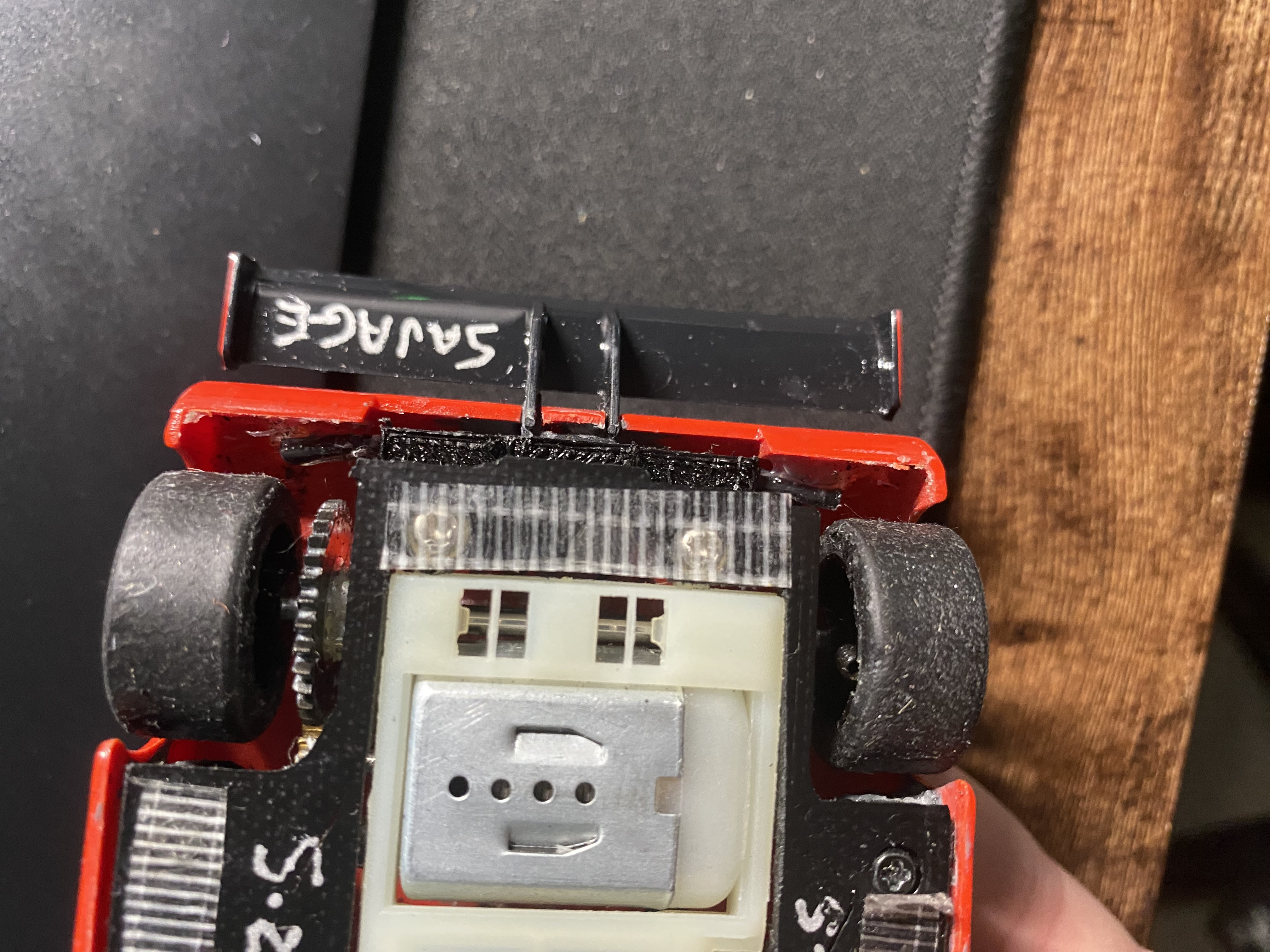

Savage's BMW LMP
Fresh tape strip at rear
[attachment=27382]
