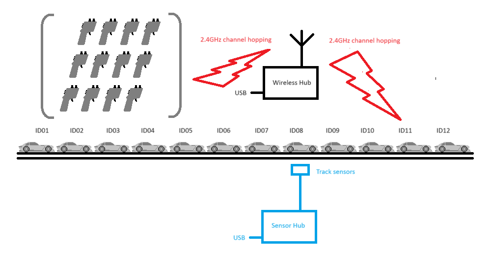

RE: Lap counting and Control - for up to 12, 24 or 36 cars - Dr_C2 - 14th-Jul-24
[attachment=36251]
Image showing the Wireless hub and Sensor hub of the new system. Both hubs a have High Speed USB connection to the race management computer.
c

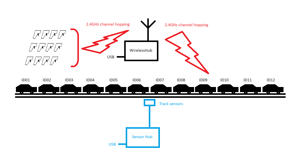

RE: Lap counting and Control - for up to 12, 24 or 36 cars - Dr_C2 - 16th-Jul-24
[attachment=36267]
Something a little closer to what we are hoping to test at Rockingham on 24th August. Many thanks to all who are assisting with preparations and of course the volunteer drivers.
c
[attachment=36269]
So hopefully this diagram describes the new digital system we will be testing at Rockingham in August.
There will be five key components under test:
1/ The new wireless in-car decoders which use IR strobing for lap counting and signalling of lane change requests. These decoders will be fitted into 12 NSR GT cars.
2/ Under-track sensors will be used to detect these 12 cars. The system is designed for detection of IDs up to 36 and has been extensively tested to date - so this part should be straight forward. That said, the tests will involve use of a new dual lane sensor board which has been designed to fit the lane pitch of Ninco track.
3/ The sensor hub and link to PC Lapcounter has been under test for many months and the version used for these trials will include anti-static/over-voltage protection on each of the eight sensor input channels and it will be packaged in a neat blue enclosure.
4/ On the wireless side, a key component is the wireless hub which receives signals from the 12 throttle controllers and onward broadcasts this information to the 12 in-car decoders. Here we will be exploring the minimum power levels required for 100% robust communications.
5/ and finally, the most important part of all, the interface between driver and the digital control system - i.e. the throttle controllers. This is under wraps at present but we have some very nice plans shaping up for August 24.
More details to follow…
c
RE: Lap counting and Control - for up to 12, 24 or 36 cars - Dr_C2 - 18th-Jul-24
A tiny little detail…
On August 24 we will be testing a 12 car setup. If that goes well, the approach will be scaled up to 36 cars and this will not require any hardware changes  to the throttle controllers or the in-car decoders. The part that will need to change is the Wireless Hub. This is designed to accommodate 1,2 or 3 communications modules. Each module can handle up to 12 cars. They are designed to be synchronised together so all three modules will either transmit or receive at any moment in time. This synchronisation piece is straight forward but not yet tested.
The design concept throughout this development exercise is to eliminate any potential communications bottlenecks as car numbers increase. Every car has a clear set of hop channels (known as frequency division multiplexing) and pre-allocated timeslots (known as time division multiplexing).
Next let’s see whether practice matches theory ;)
