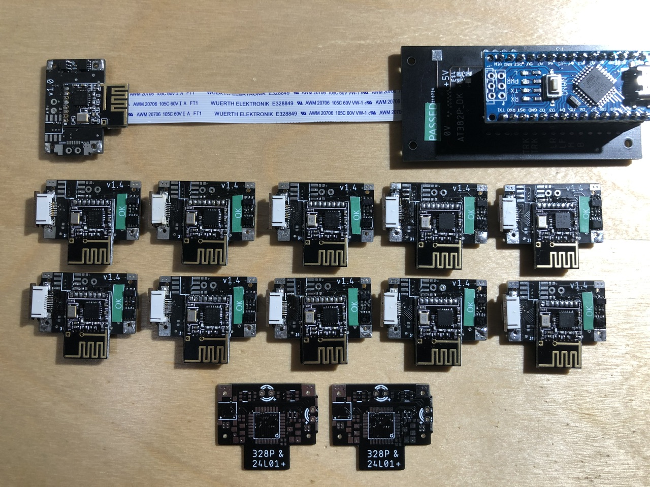

Dr_C2 - 17th-Feb-24
[attachment=33881]
A set of ten prototype in-car decoders which have been hardware tested and then flashed with prototype 12-car wireless firmware.
The two part device at the top of the photo is a variant of the hardware design where all the normal electronics is on the decoder pcb with the exception of the microcontroller itself. This sits on the larger secondary board, attached by a 16-way FFC ribbon cable.
The two part decoder design is perfect for initial testing of motor/brake pwm function, IR LED function and head/tail lights.
Then, onto the fully integrated decoder boards - these, now, have been connected to slot car chassis - the motors spool up correctly under wireless command, the brakes at 100% are very sharp, the IR LED strobe frequencies are correct for IDs and lane change, and head/tail lights function correctly including brake lights.
Next, the real test… running these new decoders (and their flashed new ‘Decoder Pro’ firmware) on the track.
As mentioned earlier the wireless approach is built up with up to three groups of 12 cars. Total is 36 cars.
So the trials need to use a group of 12 cars in the first instance.
Ten decoders are ready for these fun trials - and another two need to be built up very soon :)
All of these in-car decoders have been flashed with the channel hopping algorithm and 8 bit throttle control and 8 bit brake control - all running at 100Hz to avoid any driver perception of ‘lag’.
This is system design theory into practice ;)

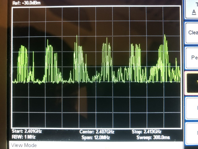

Dr_C2 - 18th-Feb-24
[attachment=33914]
Here is a technical demo of the radio spectrum output of the wireless hub component of the new 12/24/36 car wireless system demonstrating fast frequency hopping across different channels.
The horizontal axis shows frequency with 2.407GHz at the centreline. For information this corresponds to Nordic channel 07. Lower channels are to the left and higher channels are to the right.
The six signal peaks in shot correspond to hop channels. The decoders lock onto these signals and at any point in time they will use the stronger signal peaks for slot car control.
In the (future) full system implementation these peaks will be more widely distributed across the available 2.4GHz spectrum.
Thanks for reading :)

Dr_C2 - 19th-Feb-24
Thanks Drifter - it’s all working surprisingly well, so far, both the wireless hub and the observation method using the 3GHz spectrum analyser.
The setup I used picked-up the wireless signals ‘off air’ using a small antenna on the input hence the relatively high level of background noise - especially towards the right side of the photo. The spectrum is of course shared with other devices such as blutooth and WiFi devices which all have potential to create channel noise.
As per the photo the analyser is continuously scanning from 2.401GHz to 2.413GHz in small increments.
The wireless hub is frequency hopping and only sending out very short ESB payloads. Consequently the signal capture process is hit-or-miss depending on whether the hub is transmitting on the same frequency as the current value of the spectrum analyser’s frequency as the scan/sweep progresses. Hence the statistical nature of the profiles shown. I should also add, the analyser is set to ‘hold peak value’ mode so the scan pattern builds up across multiple scans/sweeps.
Hope the above makes sense :)
